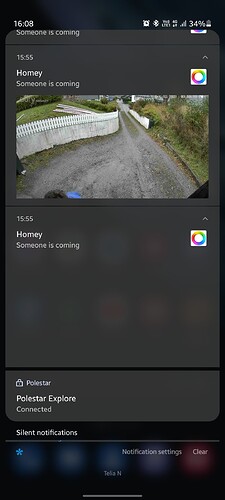

You know, I always get 2 notifications, regardless if I choose “full effect” or “include thumbnail”. See screenshot:
 ![Screenshot_20211012-160815_One UI Home](https://us1.discourse-cdn.com/flex025/uploads/athom/original/3X/8/1/81b273ac112b97accdd8045b817c5d8d56507a6d.jpeg)
Eufy app sends 2 notifications as well. Both includes text and picture…

@KristapsM yep makes so much sens 😅
This is due to the fix. Which broke the other notification
Will fix!
