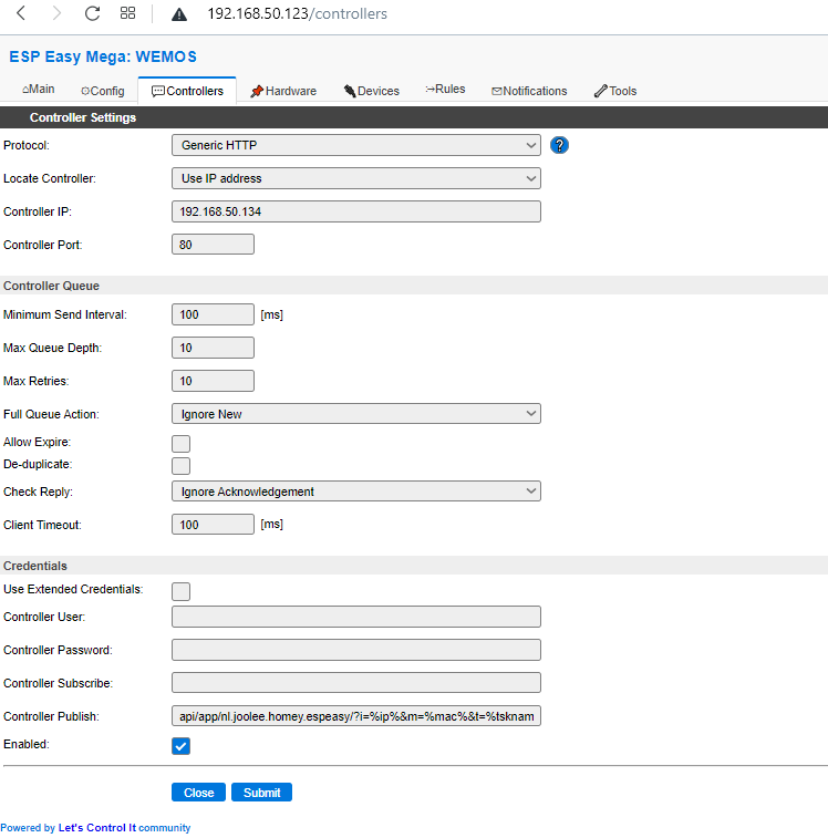

I am having problems installing a second ESP device,
i configured it completly like the first one. except of the name and unit number.
 ![afbeelding](https://us1.discourse-cdn.com/flex025/uploads/athom/original/3X/3/6/3631ce0688b2689b0f2079bba85850c6419c99a0.png)
But in homey i cant find the unit nor the IP adres of the unit… The controller settings are identical and in the ESP unit i can see that the controller has been found
 ![afbeelding](https://us1.discourse-cdn.com/flex025/uploads/athom/original/3X/a/6/a69360064e17f9e6a502fdc9a846e57eded161dc.png)
Did i mis something?
kind regards,
Vadim

The listing in ESP Easy doesn’t say that it has found Homey, just that the controller is enabled. Did you configure the URL correctly in the controller settings page?

Could you file a bugreport at Github with the necessary information? You can find a how-to on the wiki: [Get new device supported · Joolee/nl.joolee.homey.espeasy Wiki · GitHub](https://github.com/Joolee/nl.joolee.homey.espeasy/wiki/Get-new-device-supported)

Yes its a flush copy past from the other device… But i left it aside for some time and now it seems to work… (;device 1 is not powered now!)

Homey can only see the ESP board when it sends messages to it. If you don’t have a ‘system’ device that sends a message every minute, you need to wait until a device that is connected updates it’s status or just enter the IP information manually.

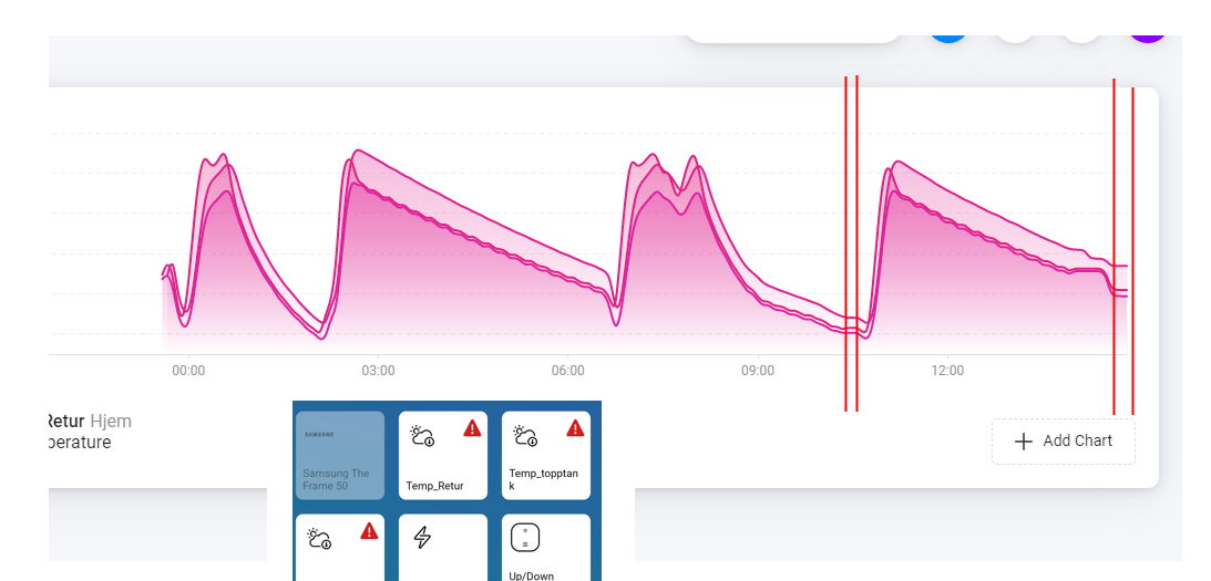

Hi. I have three temp sensors (DS18B2) connected to ESP and they report to Homey. I get graphs and everything. Every now and then, it seems like homey looses connection to ESP. ESP is still fetching temperature readings, but they are not transfered to Homey. In homey I get read triangles saying “waiting for unit”. Red lines in the image below indicates when the connection is lost. Connection is restored when I manually reboots ESP. Device values are updating even when connection to homey is lost.

From ESP log after the “connection” is lost:
```auto
03778858: HTTP : C008 connection failed (1125/0)
3779102: HTTP : C008 connection failed (1126/0)
3779349: HTTP : C008 connection failed (1127/0)
3779593: HTTP : C008 connection failed (1128/0)
3779842: HTTP : C008 connection failed (1129/0)
3781996: DS : Temperature: 27.25 (28-4d-18-c2-07-00-00-27 [DS18B20])
3782033: WD : Uptime 63 ConnectFailures 1129 FreeMem 16120 WiFiStatus WL_CONNECTED 3 ESPeasy internal wifi status: Conn. IP Init
3782275: HTTP : C008 connection failed (1130/0)
3782355: EVENT: Temp_1Tur#temperature=27.25
3782607: HTTP : C008 connection failed (1131/0)
3782856: HTTP : C008 connection failed (1132/0)
3783101: HTTP : C008 connection failed (1133/0)
3783349: HTTP : C008 connection failed (1134/0)
3783594: HTTP : C008 connection failed (1135/0)
3783843: HTTP : C008 connection failed (1136/0)
3784088: HTTP : C008 connection failed (1137/0)
3784334: HTTP : C008 connection failed (1138/0)
3784650: HTTP : C008 connection failed (1139/0)
3784898: HTTP : C008 connection failed (1140/0)
3811981: WD : Uptime 64 ConnectFailures 1140 FreeMem 16632 WiFiStatus WL_CONNECTED 3 ESPeasy internal wifi status: Conn. IP Init
3813425: EVENT: Clock#Time=Thu,16:38
Any suggestions?

These lines
```auto
Say the ESP has wifi issues.
In this line it says failed connecting to wifi 1129 times!
Wifi is connected but it’s unable to get an IP address (it was in IP initialization).

@Robin_van_Kekem. Thanks for the troubleshootin. But how can the ESP not have IP address when I are able to connect to the ESP with 192.165.50.123 as shown? Or is the connection problem between Homey and router?

Are you sure it’s related to WiFi and not to the controller connection? A quick look at the ESP Easy code suggests the latter (or at least that failure to connect to the controller _also_ increases `ConnectFailures`).

If you want to debug where it goes wrong, you could try to set up a simple webserver on your network and configure it as a controller in your ESP. You can check those logs to find out if it stops receiving updates. If you go really fancy, you could configure it as a proxy between ESP and Homey.

The creator himself🙂. Yes… I could but i believe that would be over my head. I noticed that if i disabled two out if three sensors. I noticed that homey recieved data for 12h. Not sure if that info is worth anything.

That really sounds like something going wrong on the ESP. Homey marking the complete unit as offline (which it seems to do) happens when it can’t fetch http://\<unit ip\>/json more then 5 times in a row or fails to parse it.
Can you check if you can reach that url when the ESP goes offline? If so, can you send me a crash report from the app settings page and the json result page?

The ESP is new and flashet yesterday. But I have flashed another new ESP just now and will try the same setup with that one.

All working now with the newly flashed ESP. I dont know what was wrong with the other one. If you are still interested @Joolee I will try to get the info you requested from the other ESP.

weel, I was a bit quick with the latest message.
It is not working with the newly flashed ESP. I’ve been following the tracking all day and I noticed one time that ESP lost connection but manage to restore it within some minuts. Now the connection between ESP and Homey is lost (or at least it is not logging to Homey). ESP is however connected to router, but is not accessible through web-page.
