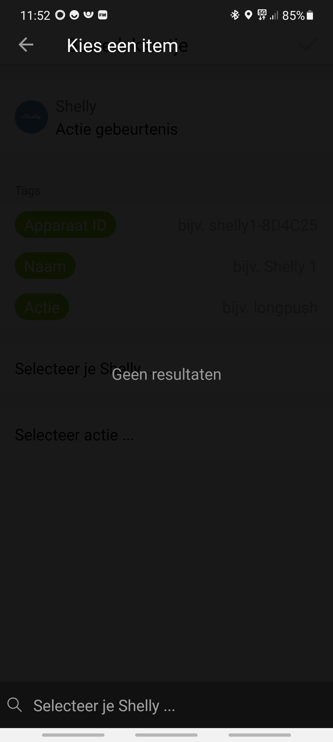

When you try to create a flow, based on a button event from a shelly i3, the shelly device is not appearing in the list of devices to select from
Latest test version of the app installed
9e350d63-c459-4ef1-95e9-0b3e53ef0de2

Downloaded again. Re-created the flows and they seem to work correct now, thanks!
I3 working again!
