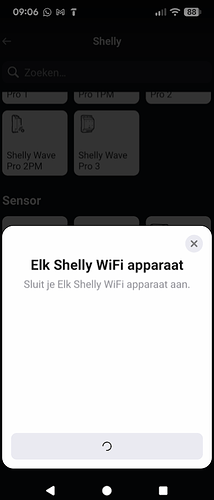

I’m having troubles adding a new Shelly device. It’s a dimmer 2 (SHDM-2), it’s included in the Wifi (with good signal) and also in the Shelly app (I don’t really use this app, but I sometimes use it to include devices in Wifi) but when I try to add it using Homey I’m stuck in this screen:L
At some point I’m getting a timeout, and then some notifications from Shelly devices that I also get when I restart the Shelly app. It seems the app crashes and reboots.
I have a Homey pro 2019 that is running around max capacity, but switching off 50% of the apps (which made my Homey run a lot smoother) does not help with adding this dimmer.
I have 37 Shelly devices currently in Homey.
