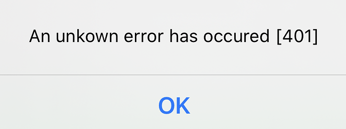

Hello, I am a new user and bought a homey specifically because of DoorBird compatibility. I have not been able to log into DoorBird inside the Homey app to connect the two and both doorbird and homey support has been of no help. I have gotten many different errors when I try to sign in and have tried with all of my accounts, admin and not, as well as the two versions prompted for. I would attached screenshots now to but add insult to injury this terrible form doesn’t allow me to upload more than one photo per post because I am a “new user.”

![IMG_7506](https://us1.discourse-cdn.com/flex025/uploads/athom/original/3X/b/b/bb0ae3c5f17a306ce035cacff8744319a84adc8d.png)

![IMG_8870](https://us1.discourse-cdn.com/flex025/uploads/athom/original/3X/5/7/578aba5077c8a99b1e7804653d431b74fd9f1b0f.png)

The first error seems to be a hiccup within Homey. The second error indicates you are not using proper credentials to log in. Please follow the instructions to the letter and create a user with the correct credentials (including api support).

I have followed the (very simple) instructions. I have repeatedly made new accounts in DoorBird with API rights and I always get this PairSession error.

That’s not an issue with my app. Someone on the developer slack channel suggested it may be solved by logging out and logging back in again on the mobile app. Give it at try and let me know.

I totally removed the DoorBird sub-App from within the Homey app, then logged out, then deleted the Homey app, downloaded it again, installed the sub-app and logged in, then created a new user account with API permissions as always in the full DoorBird app, went back to Homey and same “Could not find that PairSession” error when I try and login.

Someone else on Slack suggested this:
> The pairsession not found is because the Homey app is being put to the background when the pairing has been started, to for example copy details from a page/other app, when you then come back to the Homey app, you’ll end up with that error
I’d also like to know what you see when you directly access your DoorBird directly with this URL (replacing the IP and username/password): http://\<\<doorbird\_ip\>\>/bha-api/info.cgi?http-user=\<\<doorbird\_user\>\>&http-password=\<\<doorbird\_password\>\>

Thank you. I have been able to sign in now after manual entry. This should be written very boldly in the instructions. It is 2019 and everyone copies and pastes machine-generated passwords. I now have to click on doorbird in Homey several times to get it to open up to the video feed, etc. and I’m getting the occasional error message (503) in the opening process as well. Is this normal? Now I have the problem that “trigger default relay” does nothing and makes no sense as I have 5 relays, 3 of which are in use. Where can this “default relay” be defined and I hope more than one can be triggered at once, as my DoorBird triggers all three when entering. I do not see any place to define “default relay(s)” in Homey or Doorbird. My DoorBird model is the D2101KV and I’m using the external relay box with 3 relays (all hooked up). Thanks.
