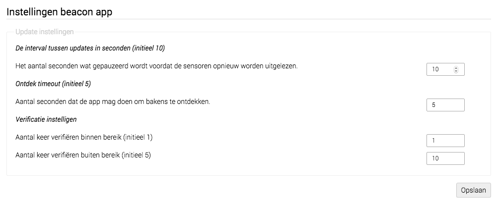

Which settings do you use?
<div class="post-metadata">
**Author:** ![jannes](https://sea1.discourse-cdn.com/flex025/user_avatar/community.homey.app/jannes/32/1945_2.png) [@jannes](https://community.homey.app/u/jannes)\
**Post date:** [December 14, 2018, 7:40pm UTC](https://community.homey.app/t/app-pro-beacon-detect-your-presence-with-ble-beacons/3550/67 "2018-12-14T19:40:01Z")
</div>
![36](https://us1.discourse-cdn.com/flex025/uploads/athom/original/2X/b/b9031e11c0a6997639e31832bd7590372aa1df87.png)
**Author:** ![Koktail](https://sea1.discourse-cdn.com/flex025/user_avatar/community.homey.app/koktail/32/51498_2.png) [@Koktail](https://community.homey.app/u/Koktail)\
**Post date:** [December 14, 2018, 8:06pm UTC](https://community.homey.app/t/app-pro-beacon-detect-your-presence-with-ble-beacons/3550/68 "2018-12-14T20:06:09Z")
</div>
Can you try a discovery timeout of 10 seconds. And send a report to the developer if it does not work. 😃
