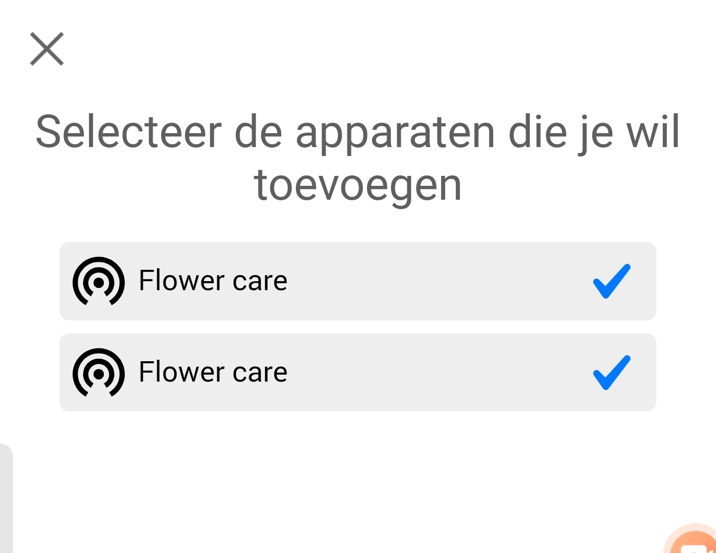

> [@Glenn\_Dijkstra](#):
> I found way more devices than I could ever find with this app.
Me too, and look, Flower care pins can also be used as beacons🤪
 ![Screenshot_20210421-233047_Homey](https://us1.discourse-cdn.com/flex025/uploads/athom/original/3X/0/8/08d0eebf2efa79b9e5531585d8bca9099fab6353.jpeg)
<div class="post-metadata">
**Author:** ![Koktail](https://sea1.discourse-cdn.com/flex025/user_avatar/community.homey.app/koktail/32/51498_2.png) [@Koktail](https://community.homey.app/u/Koktail)\
**Post date:** [April 21, 2021, 10:05pm UTC](https://community.homey.app/t/app-pro-beacon-detect-your-presence-with-ble-beacons/3550/581 "2021-04-21T22:05:40Z")
</div>
They are. Stick one in you pocked and you will see 😬
