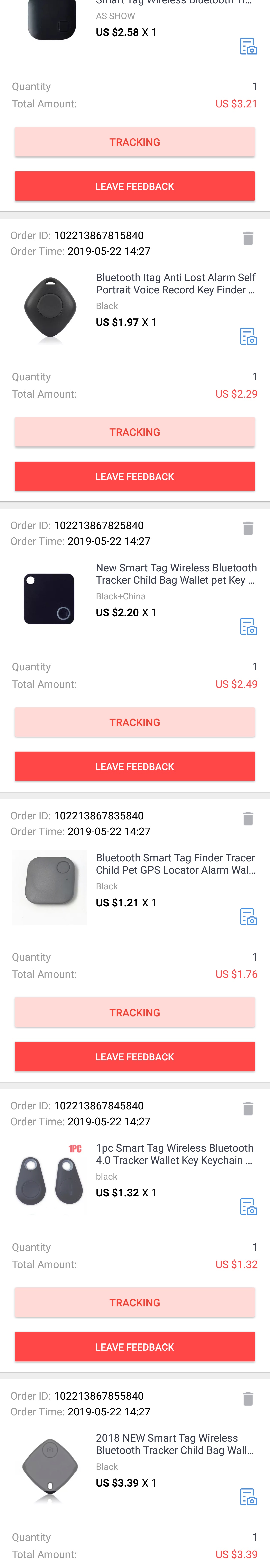

I am not sure but it maybe depends on each beacon how it behave itself. Maybe its software sets it to sleeping mode, in other words its not detectable without ptp. I have bought several cheap beacons from ali and it seems only two are suitable for me (first and last one). I use them for presence of family members (attached to the keys). Some of them stop to be detected after some time and neet to be woken up. My settings you see below. I give it some time to have the beacon recognized as away.
 ![homey](https://us1.discourse-cdn.com/flex025/uploads/athom/original/2X/8/8dbb71f05004b8b6faa70b7d96ba96fc5e18cb3e.png) ![aliexpresshd](https://us1.discourse-cdn.com/flex025/uploads/athom/original/2X/f/f95535ae6bd31782febcfb11f0ff611df659a613.jpeg)
