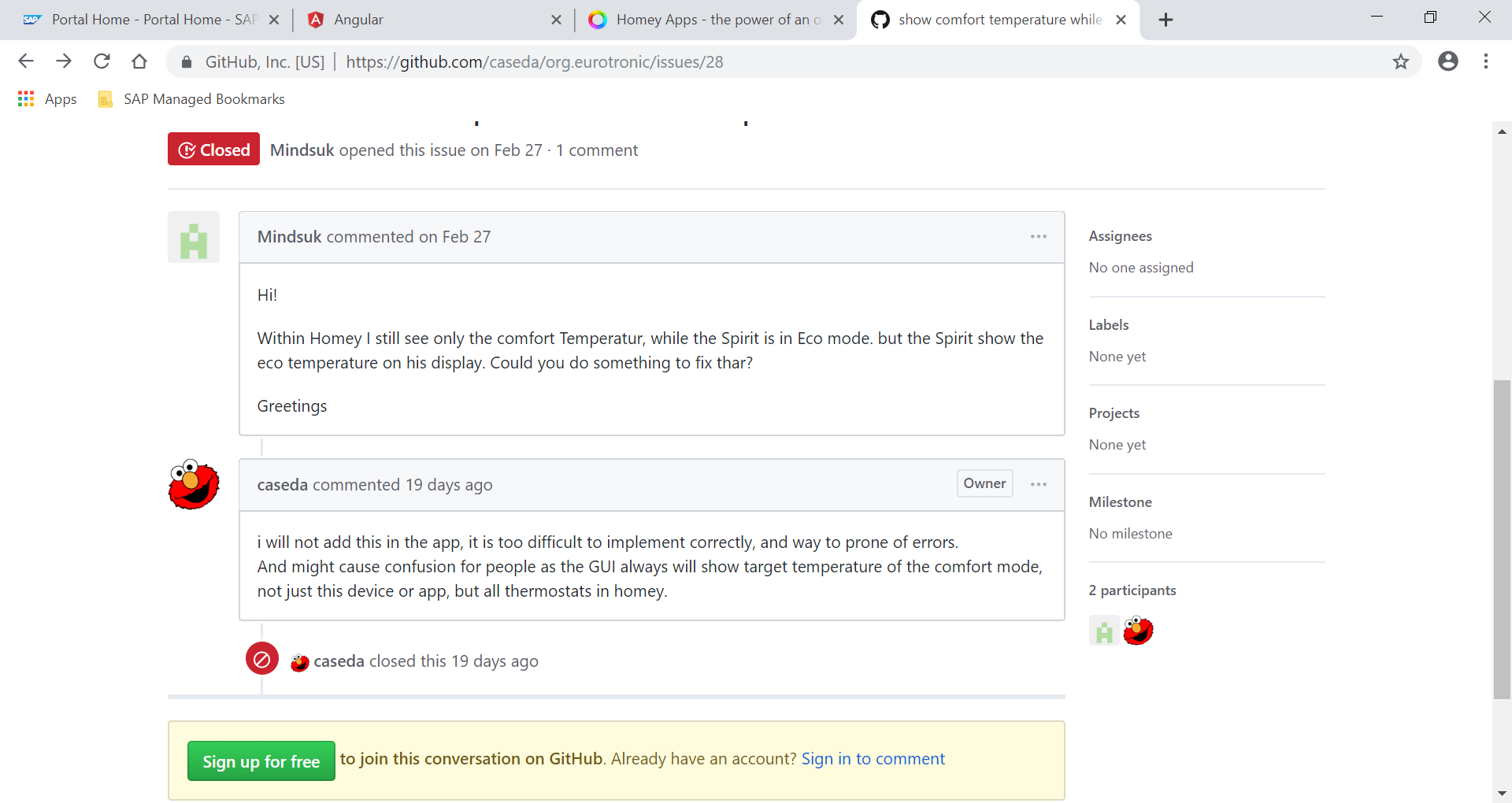

This is a question to Caseda (sorry, I don’t know how to post it otherwise):
Hi Caseda!
I am referencing this closed issue
 ![image](https://cdck-file-uploads-us1.s3.dualstack.us-west-2.amazonaws.com/flex025/uploads/athom/original/2X/c/c3035da3ce78dc61354ae57a756848b4b5cf7693.png)
and would like to add a question:
In the case that Mindsuk describes, does your answer mean that what the thermostat shows is incorrect and in reality it is regulating the room temperature to what the homey app (and homekit) show?
I am asking because I have the same issue and found out that when I press a button on the thermostat, the display immediately switches to what Homey shows.
Thanks a lot for helping me understand.
Best
Manfred
<div class="post-metadata">
**Author:** ![Caseda](https://sea1.discourse-cdn.com/flex025/user_avatar/community.homey.app/caseda/32/138695_2.png) [@Caseda](https://community.homey.app/u/Caseda)\
**Post date:** [May 23, 2019, 2:27pm UTC](https://community.homey.app/t/app-eurotronic-technology-app-stable-v3-0-1/5771/113 "2019-05-23T14:27:57Z")
</div>
There is a nice official topic for this app.
I’ve moved it to there.
The device has 3 different “target” temperature values in its memory.
Comfort temperature, economic temperature and the off temperature.
Off temperature is not changeable.
The other 2 are, the gui will **always** change the comfort mode, even if it would be in the economic mode.
This is just to stop confusion like I addressed in that github issue.
If you press the + or - button on the thermostat when it is in economic mode it will switch to comfort mode, this is done by the thermostatic itself and not Homey, I / Homey can’t change this behaviour.
So Homey has kinda the same behaviour when you move the temperature, so to stop this confusion that happens on the thermostatic, I only show and change the comfort mode from the GUI.
If you press the middle button it will always go to boost mode, this is also not behaviour I can change.
And fully determined by the thermostatic.
His question was that if the thermostatic is in economic mode, that it still would display the comfort temperature target, and not the economic temperature.
But as you already notice on the thermostatic itself, it is really hard to implement well, and this was just what could cause the least amount of confusion.

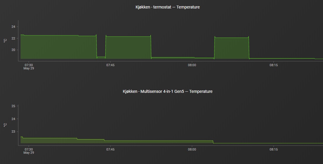

I have the same flow as you, sending the temperature value to the Spirit each time the temperature changes, and I have exactly the same behaviour.
When a temperature value is sent to the Spirit, the Spirit reports that value for a while, and then it returns to what is probably its internal reading.
However, I don’t think this affects the actual temperature regulation of the Spirit, so this is probably not a big deal.
I’ve attached Insight-pictures from three different Spirits. In each picture, the upper graph is from the Spirit, while the lower graph is from the external temperature sensor.

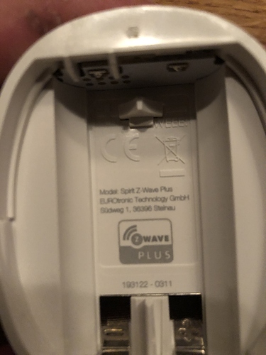

Hi!! Received my Spirit devices today. I tried to connect them to Homey via the app and general zwave but it doesn’t work… Homey is on version 2.5.2 and therefore not allowed to install the beta version of the app. What am I doing wrong?
**Post date:** [October 2, 2019, 7:08pm UTC](https://community.homey.app/t/app-eurotronic-technology-app-stable-v3-0-1/5771/120 "2019-10-02T19:08:19Z")
</div>
And you are sure you have the z-wave version and not the zigbee (not supported) version?

Yes, it’s a zwave-plus version. I pressed the boost button and the light starts blinking and device is in ‘Inc’ mode. After some time I get messenger that no z-wave device could be found. I placed the device next to my Homey.
 ![image](https://us1.discourse-cdn.com/flex025/uploads/athom/original/3X/3/7/37e9f13d6e58cd6871d0d42f28d0ce0e77d574cf.jpeg)
