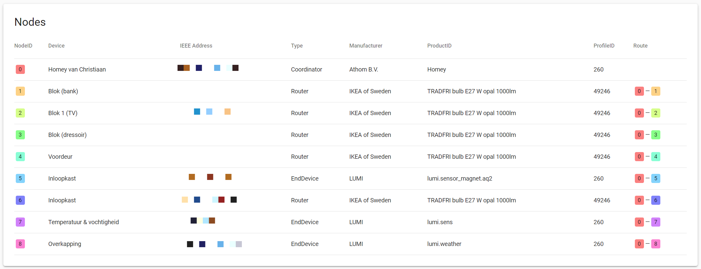

Sounds to me that the battery sensors are meshing via the bulbs. Then the bulbs stop responding and the values don’t reach Homey anymore. But that’s speculation.
Can you post a screenshot from your Zigbee mesh ([https://developer.athom.com/tools/zigbee](https://developer.athom.com/tools/zigbee))?
Oh, btw, do you switch your bulbs off through Homey or remote or physically with a wall switch? In the latter case, they lose power and will be not responding anymore. They will also stop forwarding any signals…
Btw 2: are the bulbs connected directly to Homey or via a Tradfri hub?

> [@PetervdK](#):
One of them does. That one is located in the bathroom. The other I don’t know. It’s just 1 meter distance from the sensor to Homey, but Tradfri bulbs are around, so maybe meshing, maybe not …
> [@PetervdK](#):
The bulbs are switched on and off by Homey only.
> [@PetervdK](#):
I do not own a Tradfri bridge. I have them connected to Homey directly
<div class="post-metadata">
**Author:** ![PetervdK](https://sea1.discourse-cdn.com/flex025/user_avatar/community.homey.app/petervdk/32/20669_2.png) [@PetervdK](https://community.homey.app/u/PetervdK)\
**Post date:** [May 6, 2019, 4:13pm UTC](https://community.homey.app/t/all-zigbee-devices-not-working-after-ip-change/12731/12 "2019-05-06T16:13:57Z")
</div>
That clarifies and rules out some things. But still, a screenshot might be handy for evaluation. Could still be that the problem lies with the bulbs and not with the sensors.
**Author:** ![Christiaan](https://sea1.discourse-cdn.com/flex025/user_avatar/community.homey.app/christiaan/32/13030_2.png) [@Christiaan](https://community.homey.app/u/Christiaan)\
**Post date:** [May 7, 2019, 12:04am UTC](https://community.homey.app/t/all-zigbee-devices-not-working-after-ip-change/12731/15 "2019-05-07T00:04:50Z")
</div>
> [@PetervdK](#):
 ![image](https://us1.discourse-cdn.com/flex025/uploads/athom/original/2X/b/b7ad35bbb5dfd22ba7971fcf0419ad17bc82ede1.png)
