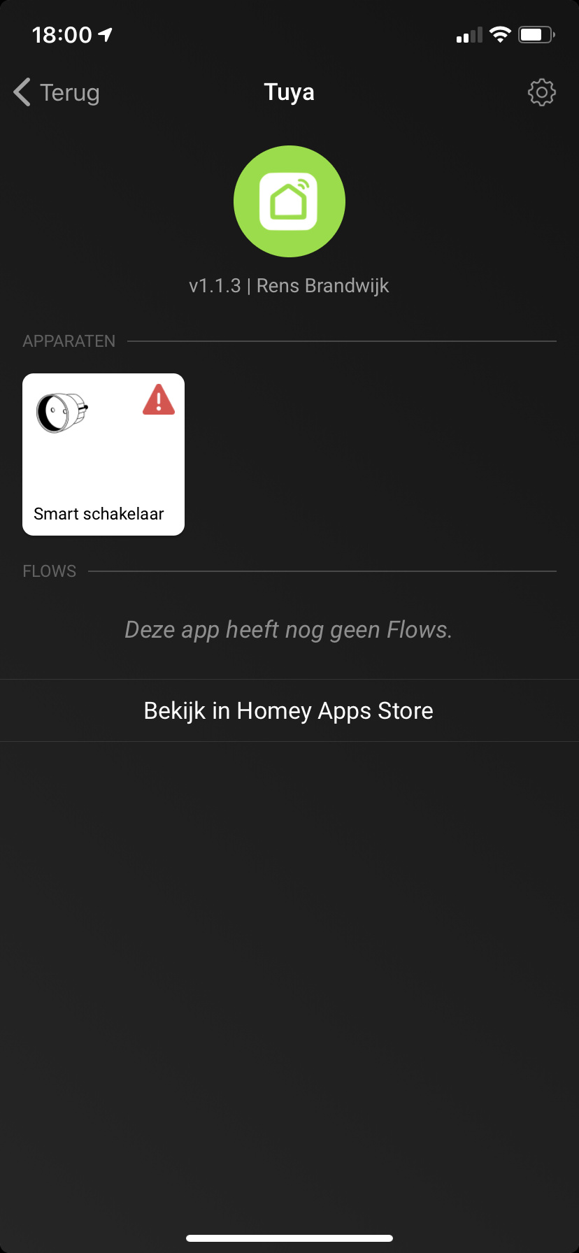

Wolter is using the Tuya app for local connection, which app are you using? The app I made is using the Tuya cloud.
<div class="post-metadata">
**Author:** ![Sjors\_Alberts](https://sea1.discourse-cdn.com/flex025/user_avatar/community.homey.app/sjors_alberts/32/17337_2.png) [@Sjors\_Alberts](https://community.homey.app/u/Sjors_Alberts)\
**Post date:** [November 21, 2019, 5:01pm UTC](https://community.homey.app/t/action-lsc-smart-connect/16814/113 "2019-11-21T17:01:10Z")
</div>
I am using this one…
 ![image](https://us1.discourse-cdn.com/flex025/uploads/athom/original/3X/f/e/feace1d7ee14953a810b255401d91572f407677f.jpeg)
**Author:** ![Jurgen\_Heine](https://sea1.discourse-cdn.com/flex025/user_avatar/community.homey.app/jurgen_heine/32/15323_2.png) [@Jurgen\_Heine](https://community.homey.app/u/Jurgen_Heine)\
**Post date:** [November 21, 2019, 6:08pm UTC](https://community.homey.app/t/action-lsc-smart-connect/16814/114 "2019-11-21T18:08:17Z")
</div>
Thats the local Tuya app made by Rens Brandwijk. But Wolter last answere was to remove and add the device again, but without IP, only ID and key. If this is not working for you, you could try to contact Rens Brandwijk.
