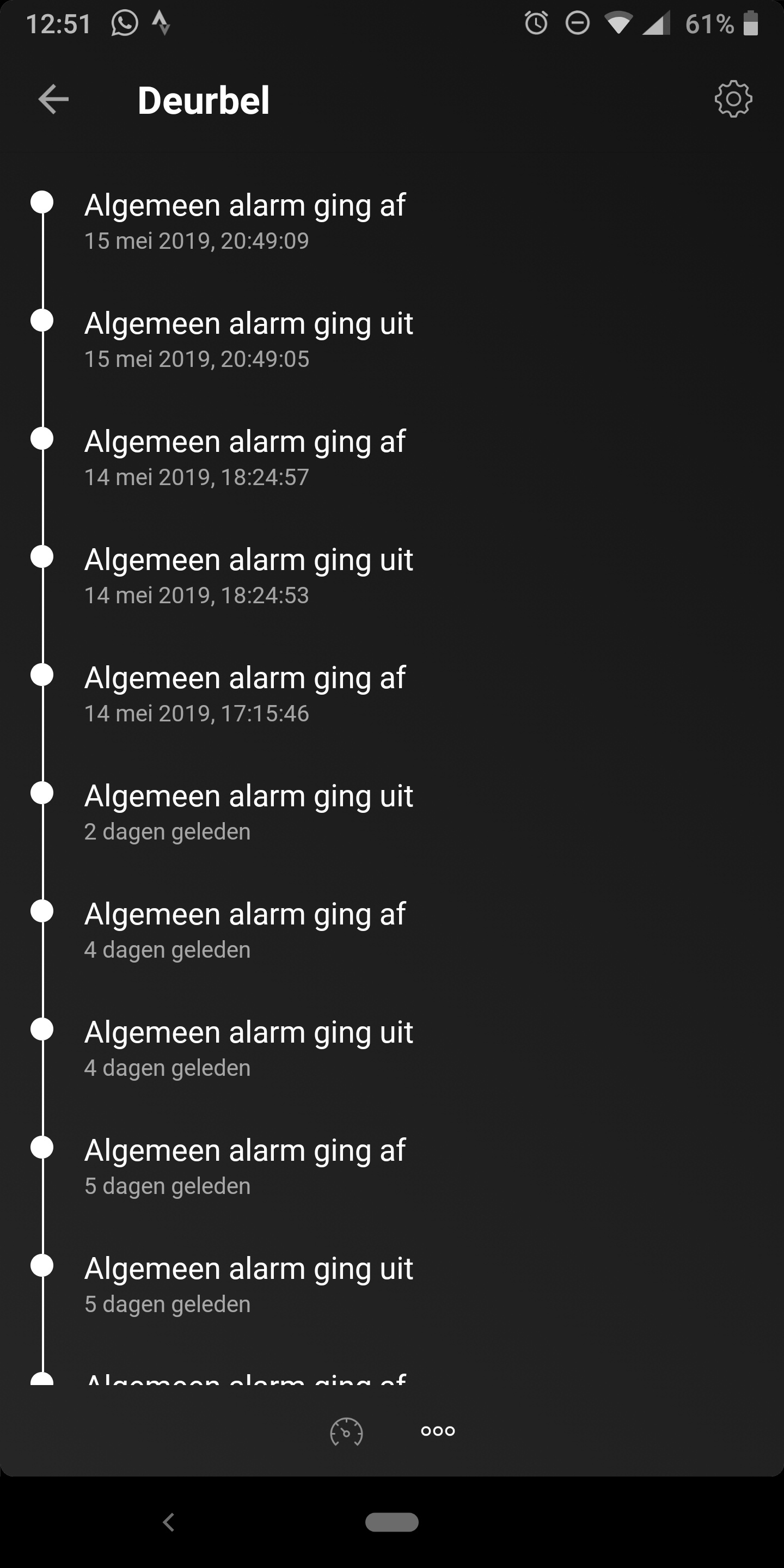

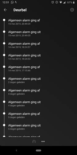

I bought myself a doorbell at the Action last week, so I can let Homey send push-messages to my mobile devices when there is someone at the door.
But the doorbell also has a general alarm state. This stays in alarm:yes state until the next time the button is pushed. After the alarm is cleared it goes in alarm state again after 4 seconds and so on…
I’m not really sure what the function of the ‘general alarm’ is or how to manually reset it, is anyone else using this function?
In my mind pushing the doorbell may raise this alarm but in that case I’m not sure why you can either choose the ‘button pushed’ aswel as ‘alarm raised’ in the IF card…

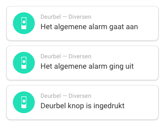

Also when the button is pushed apparently the signal is send twice resulting in 2 identical notifications. That’s why I’ve configured the flow in such a way that it will disabled for 5 seconds right after starting to prevent this from happening. But I’m not sure this may contribute to the issue with the general alarm… Looking at the time in the logs this certainly would be an explanation but I’m curious if I’m the only one with the dual notification ‘issue’ in the first place.

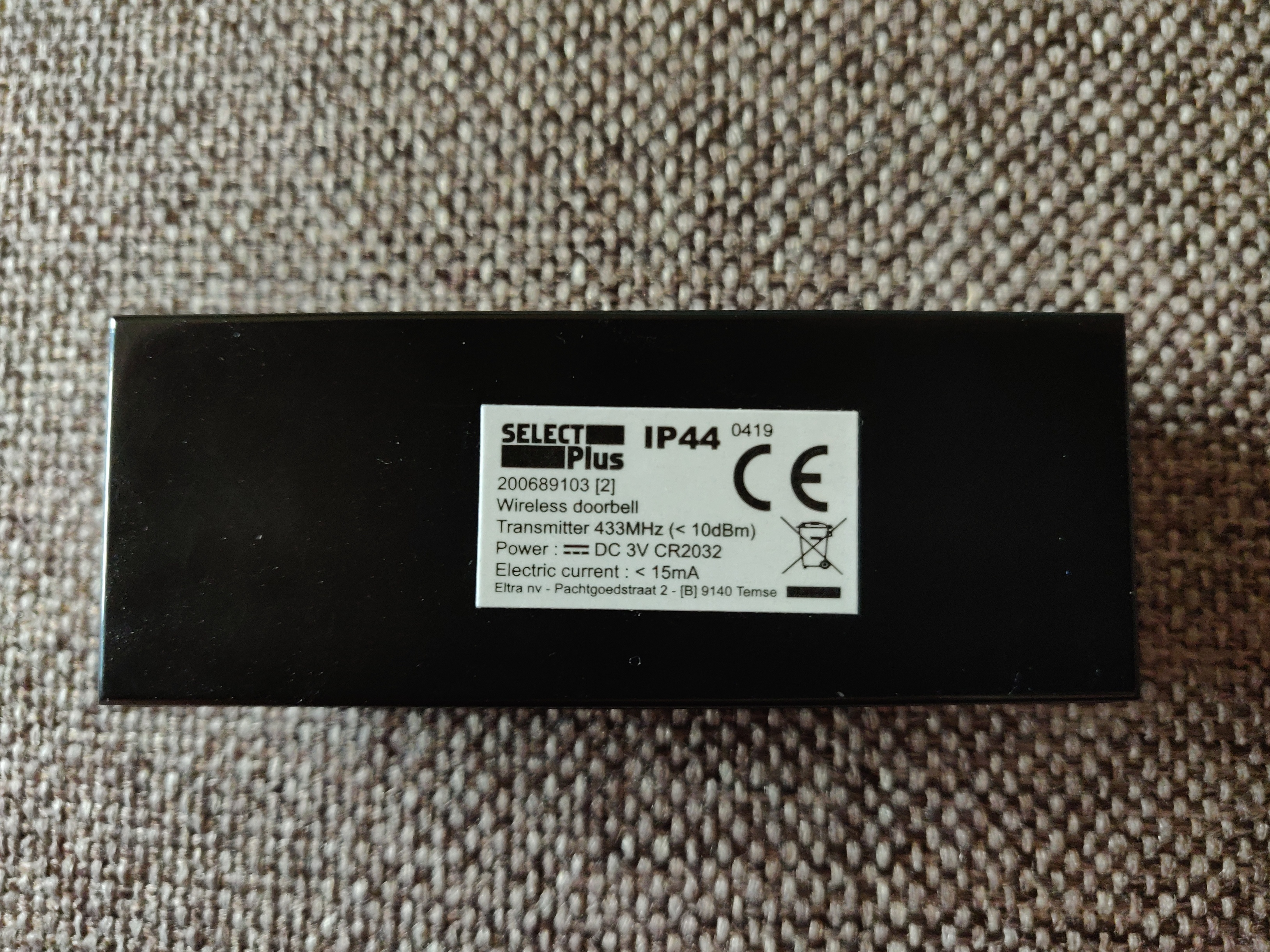

Today I was in an Action and noticed that the black doorbell version is a 103 instead of the 101. I’m going to test it tomorrow.

Well, that was a disappointment. Adding the 103 didn’t work at all, but when I tried it as a 101 it worked immediately, but with the same wrong alarm setting in homey. It’s definitely a 103 version as you can see on the label.
 ![IMG_20190824_090007__01](https://us1.discourse-cdn.com/flex025/uploads/athom/original/2X/8/8d93b98e6712e6d886012aab2d786093a8721aba.jpeg)
Sent the information to Athom. I tried 2 103 devices. No luck. Got a few replies from Athom to test and send information. Did all of that…then one last email from Athom…we sent it to development…that’s it. Sorry, Athom support sucks. They ask you many questions, you send them all the information asked and in the end nothing happens.
